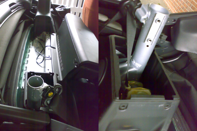

Fitting turned out to be a complete PITA. In theory, all you do is pop out the inserts in the top of the turrets and fasten the bracket to the roll-hoop mount underneath using the nifty expanding fingers on the brackets.
This is where I came unstuck - my turrets are filled with polystyrene and a plastic plug seemingly to keep muck out of the roll-hoop brackets. It proved impossible to extract this through the hole in the top of the turret, so I had to remove them. The real PITA is that two of the screws that hold the turrets on are obscured by the storage box, so that had to come off too! Having stripped what felt like half the trim off the car, it was then an easy matter to cut the polystyrene, put the turrets back on, reassemble the car and finally fit the deflector. Took me two and half hours! :roll:
I took a couple of pics of what I found underneath the trim. Look to me that the outer roll-hoop mounting tubes are welded to the car and that the threads are there to bolt the inner ones on should I ever choose to add roll-hoops (in fact I could probably have fitted roll-hoops in the time it took to do the deflector :lol:). The cable you can see if for my own CD multi-changer which is fitted inside the storage box. The second pic shows how the seatbelt reel sits and how the belt is anchored to the top of the roll-hoop mounting.

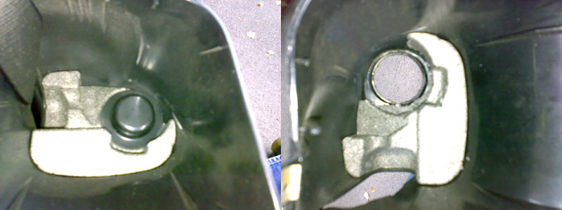

This is the inside of the turret, showing how it is filled with polystyrene and had a plastic cap that goes into the roll-hoop mounting, and how I simply cut this away to allow the deflector bracket to fit through.

Thanks for the pix. But I can't quite make out what|I'm seeing in the last 2 ?

minniebannister wrote:Thanks for the pix. But I can't quite make out what|I'm seeing in the last 2 ?
I'm not sure my phone has done the best job of focussing on the bottom 2 - these are the inside of the turret whilst I was working on it - you can see it on the car at the top of the first photo - I've taken it off the car and turned it upside down - you can just see the seatbelt still going through it on the left hand one - and for some reason the leg of my jeans. :oops: :lol:
The polystyrene seemed to be stuck to the inside of the turret, so rather than remove the lot, I cut round the round plastic plug in the left hand photo to remove both the plug and make a hole - in the right hand photo you are looking through the hole right through the top of the turret.
