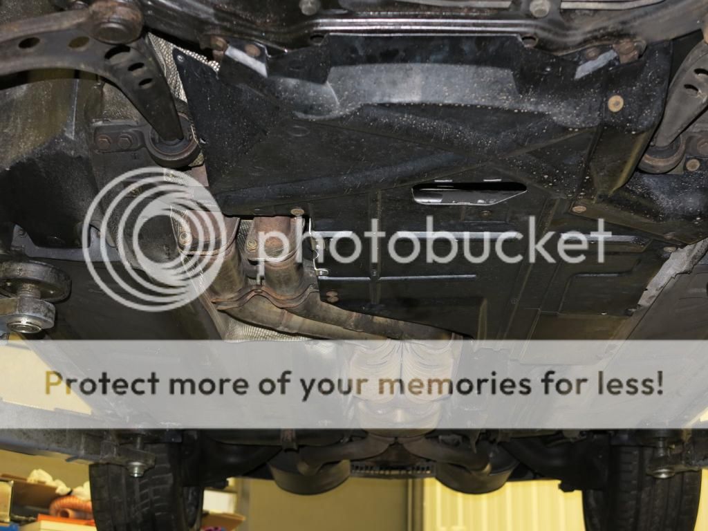

All undertrays are smashed and damaged. Cable ties are holding them on. New ones will be purchased while they are still available.

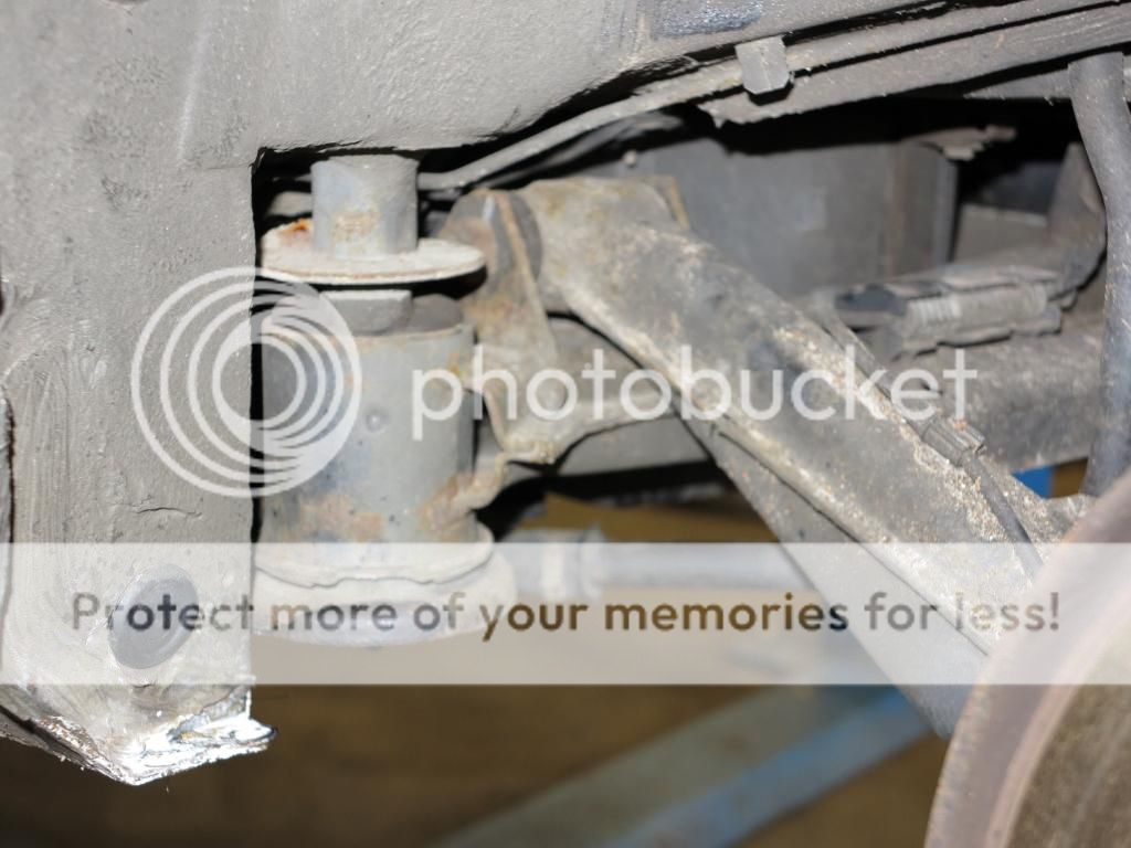

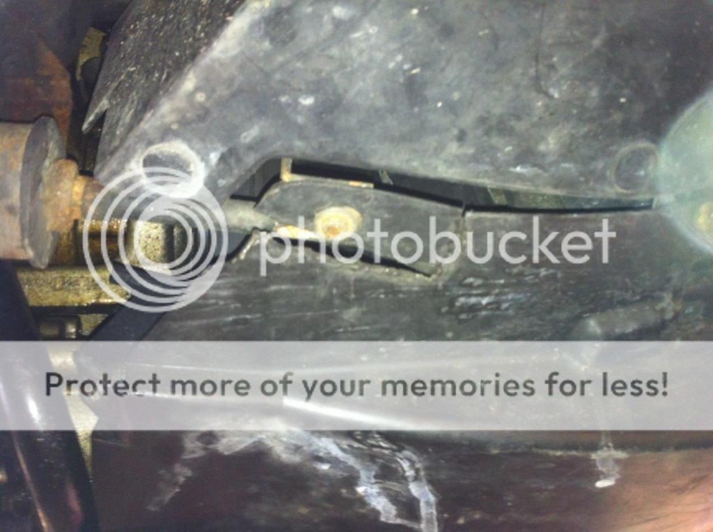

Brake and fuel pipe clip missing and pipes bent. Need securing correctly. Looks like it happened when the canister was damaged.
Rear anti roll bar maybe slightly bent. It has come out twice over ten years. When the rear axel is dropped this will be checked.

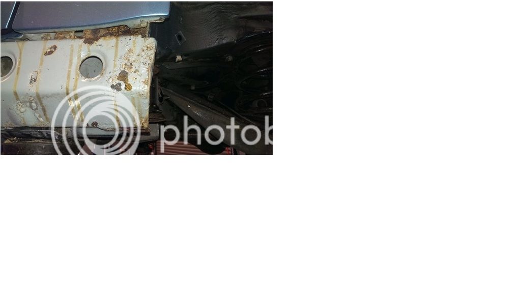

There are two small dents in o/s/r floor pan and n/s/f chassis leg caused by objects hitting underside of car.
There is slight surface corrosion to the boot floor and spot welds, rear sill edges, rear wing inner joins, rear floors, both lower front wing edges. These will have to be cleaned back to bare metal, treated with Kurust, etch primed, 2K stone chip applied and then painted.
While this is being done and the shields and undertrays are replaced they will clean the underside of the car and thoroughly Waxoyl everything.
This will repair all the damage and ensure long term protection.

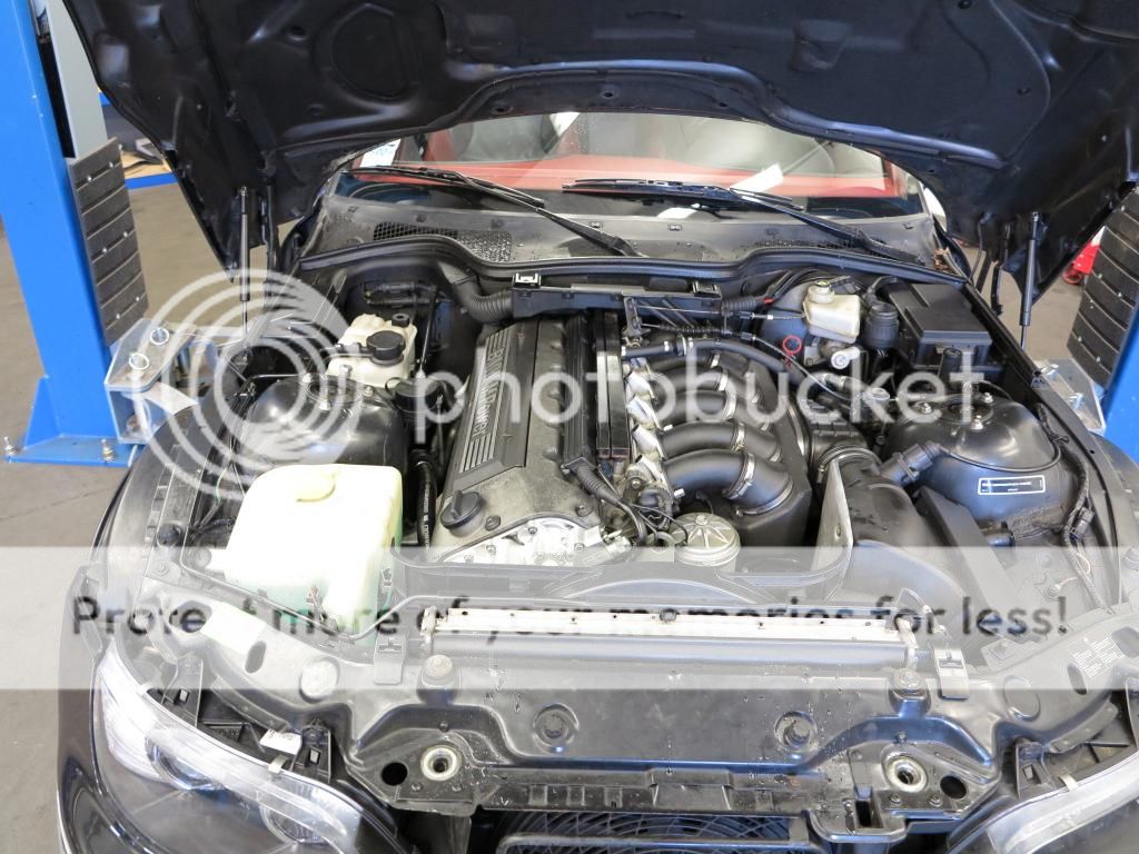

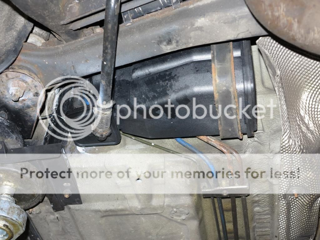

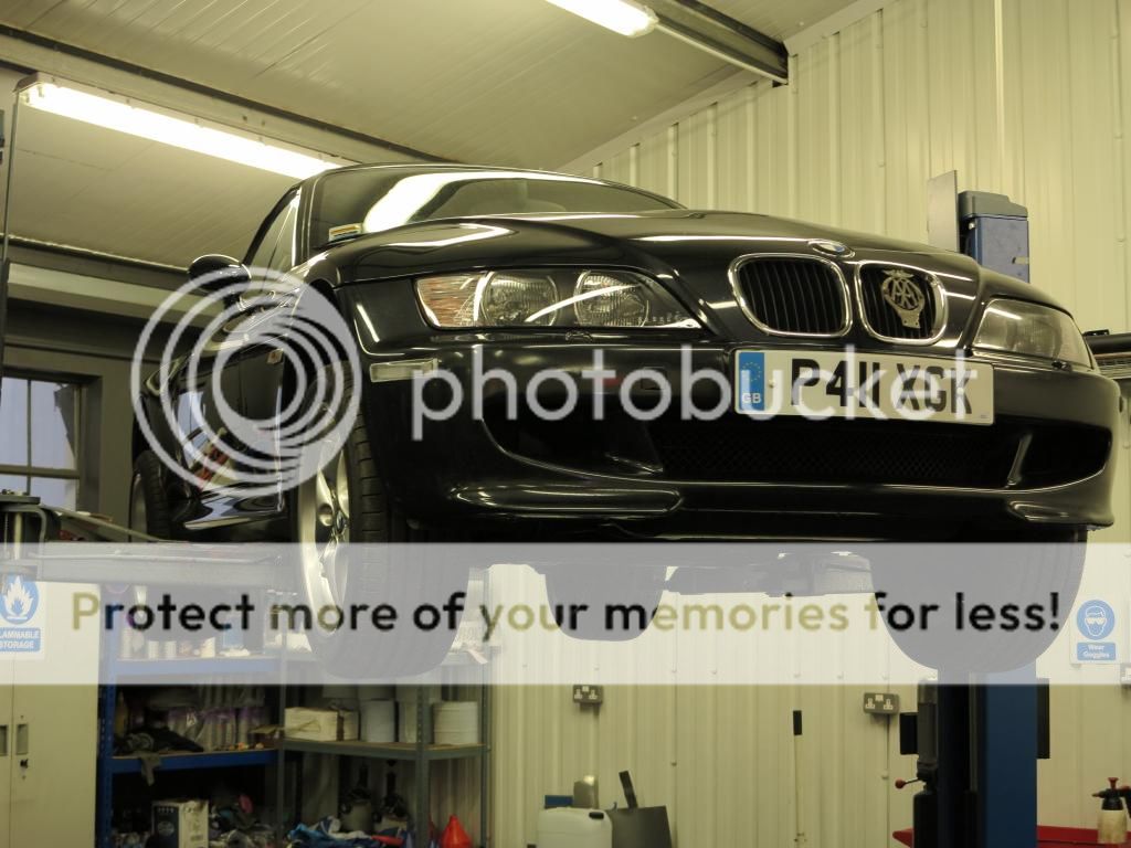

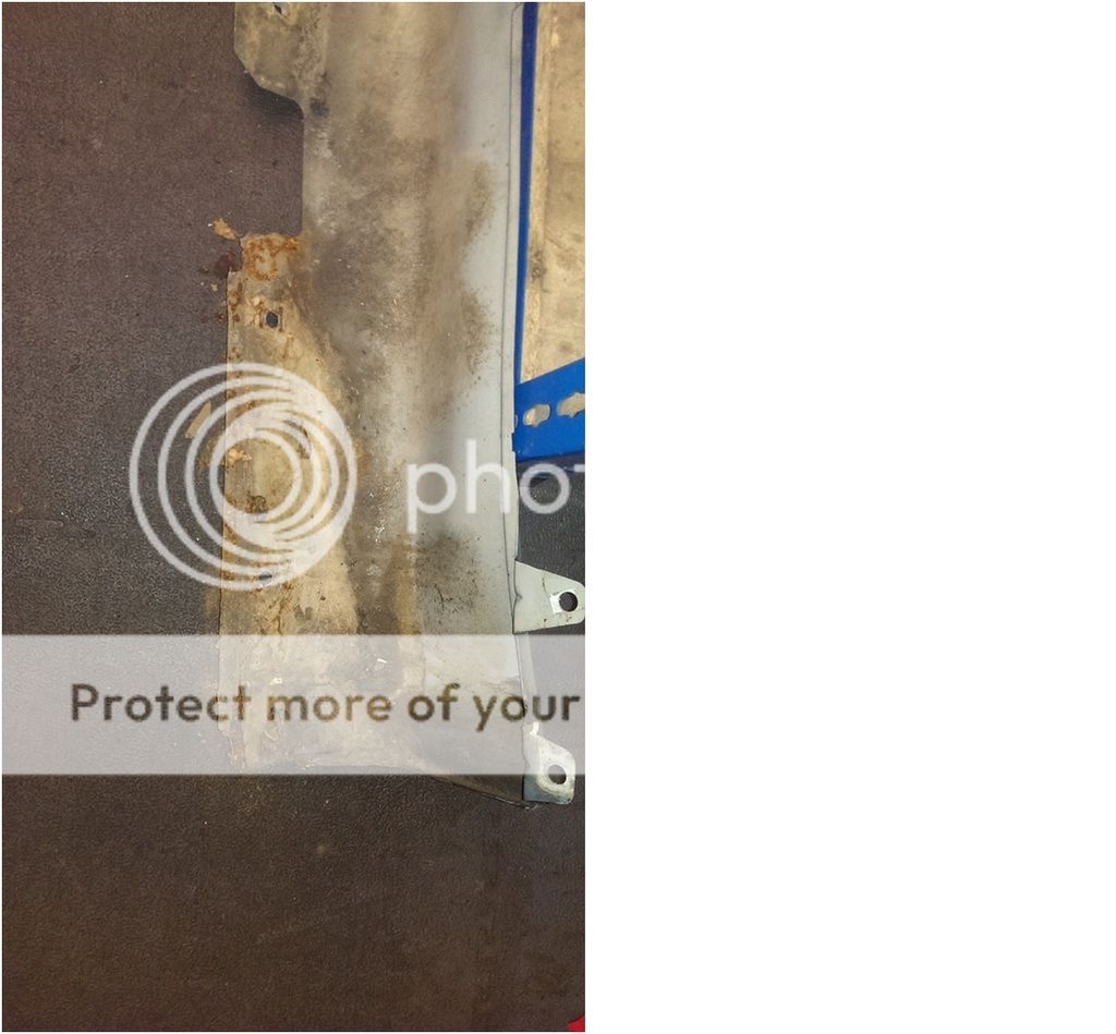

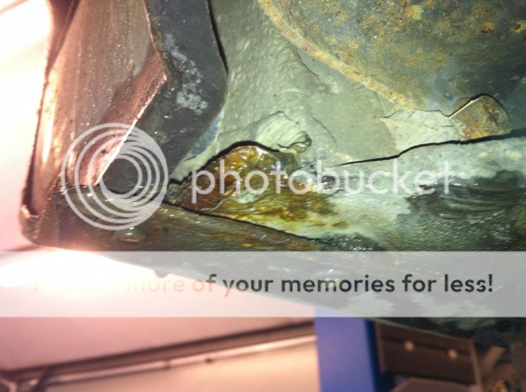

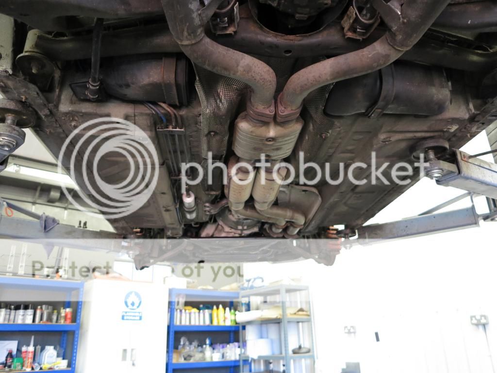

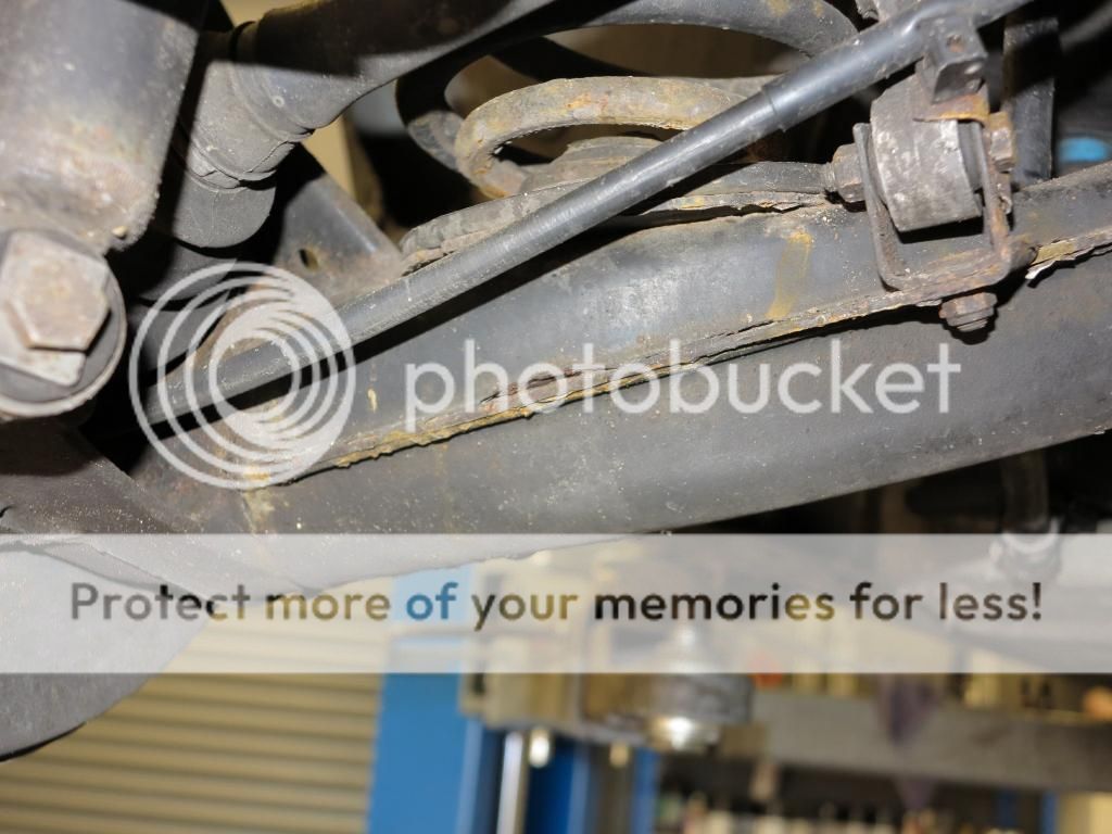

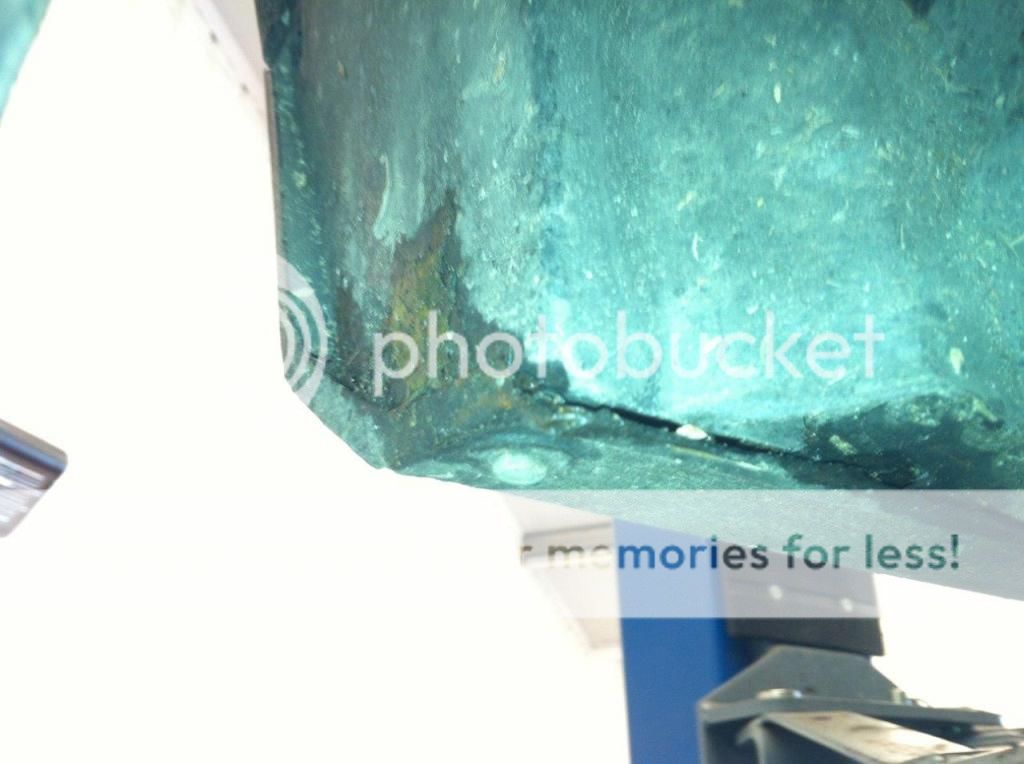

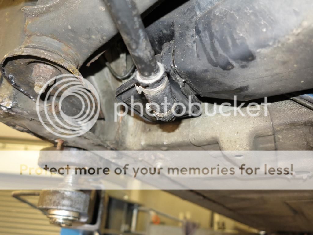

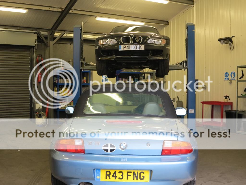

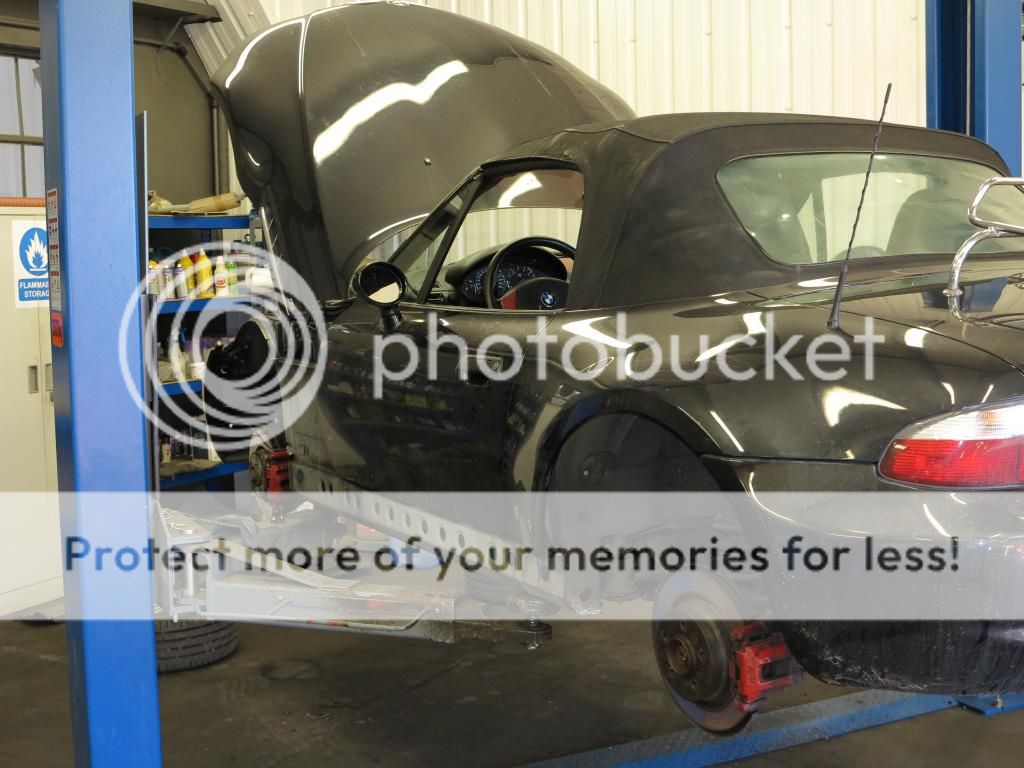

work has now started so I thought I would share some pics. Came as quite a surprise as to what appeared.
First the car about three months ago. Original paint work after 80,000 miles. Never resprayed and all chips and dents still in place.

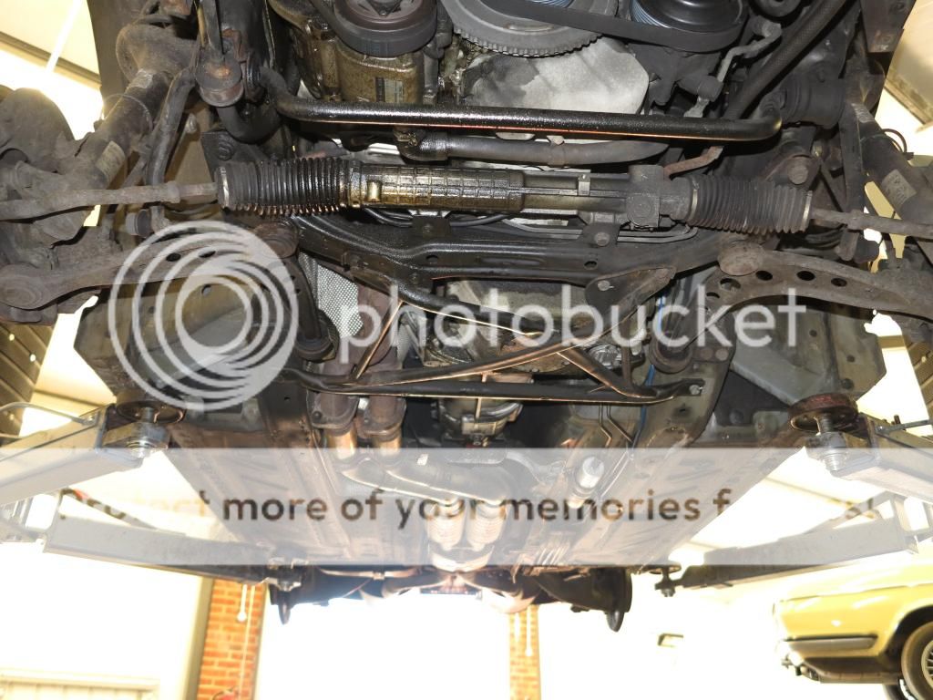

Underside revealed a different story.
First bent exhaust clamp.

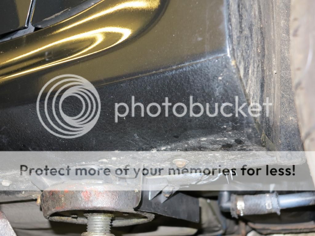

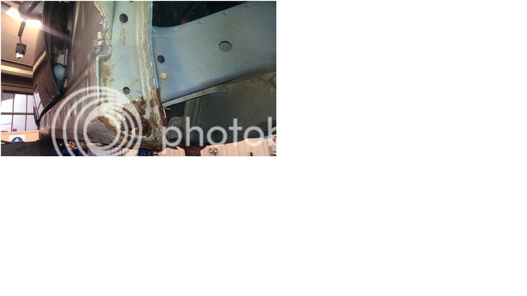

Sills looked a little suspect but what lay behind?
Floor pan also has surface rust

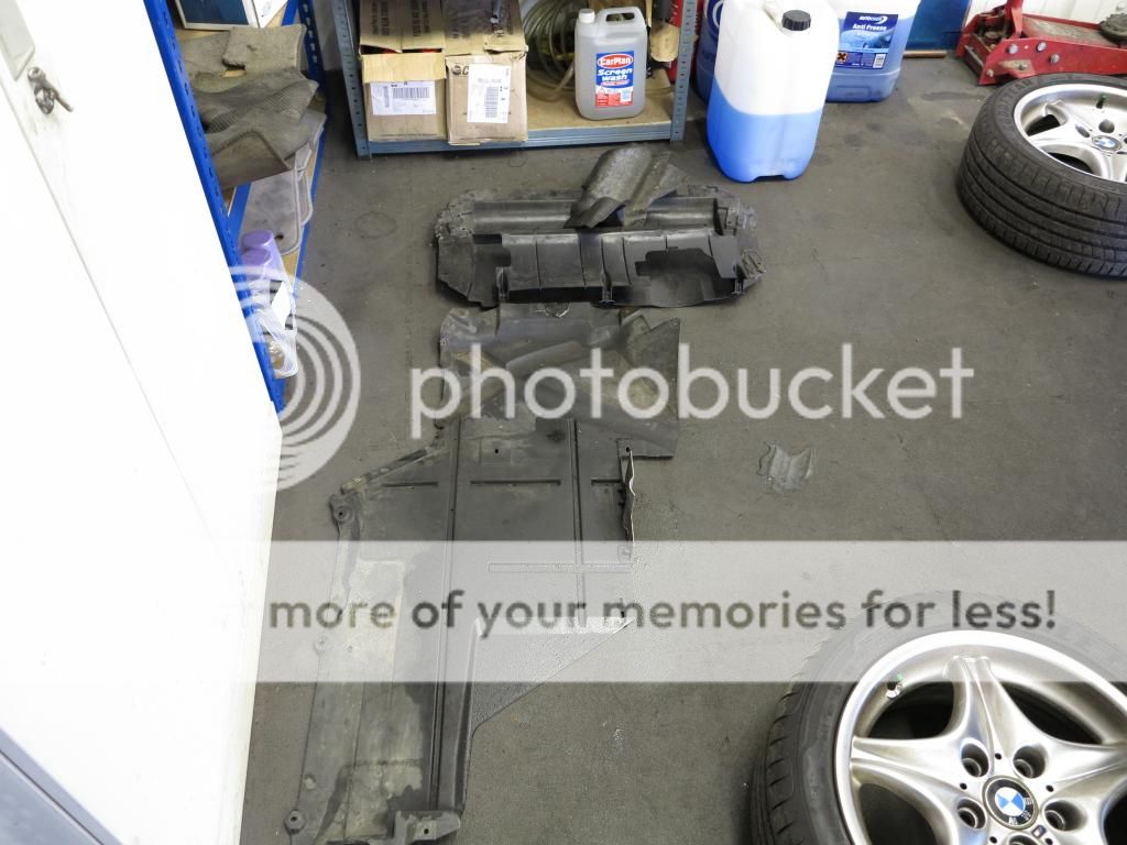

The undertrays and splash shields are all broken
Undertray bits to be binned
Removal revealed other problems.
Oils leak from vanos
Leaking seal on diff speedo pickup

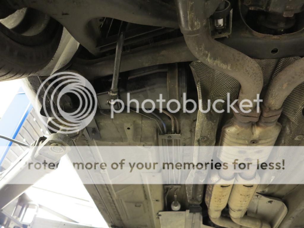

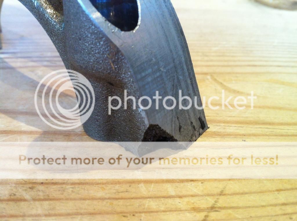

A broken cabon capture. I didn't even know it had been broken and badly repaired.

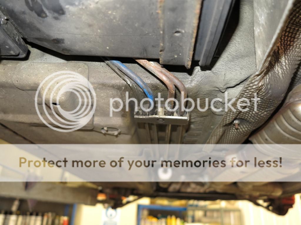

When it was broken it caused damage to a breakpipe clip and bent and moved some of the pipes. I recon it slipped off a jack.
You could then see all the surface corrosion.

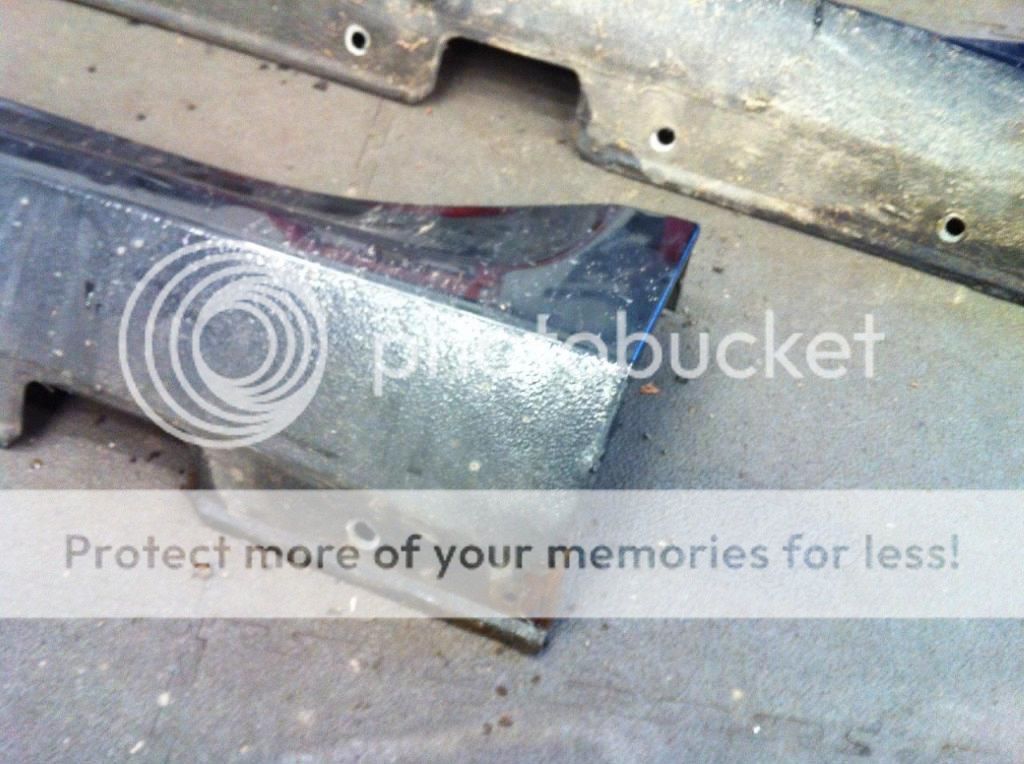

Time to remove the wings and sills
This revealed the bump stops on the front suspension had disintergrated

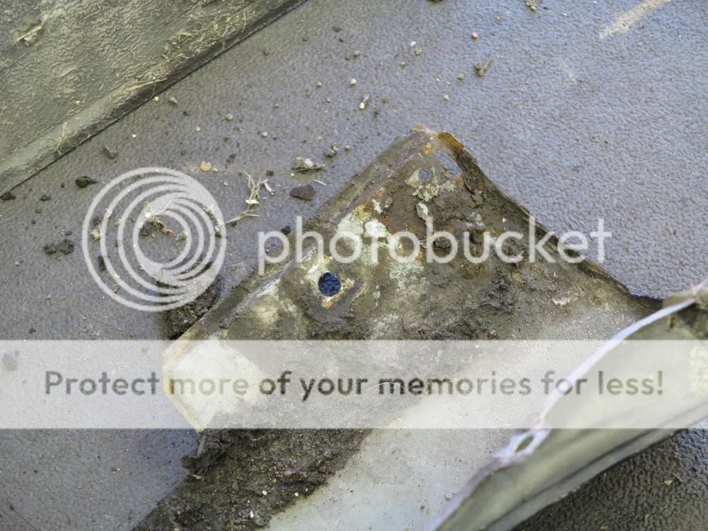

What about the sills. It was amazing the rubbish behind them.
And there were holes in the metal

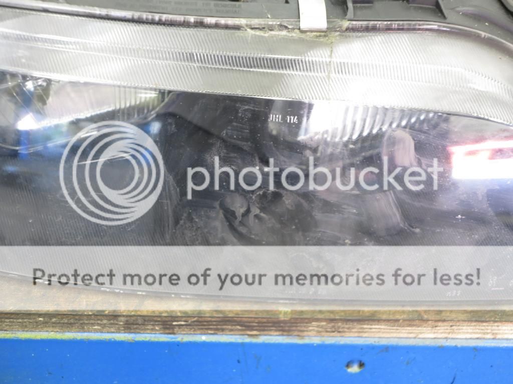

On top a cracked headlight. It is letting in water and will get worse.
So it has to go. Gone!

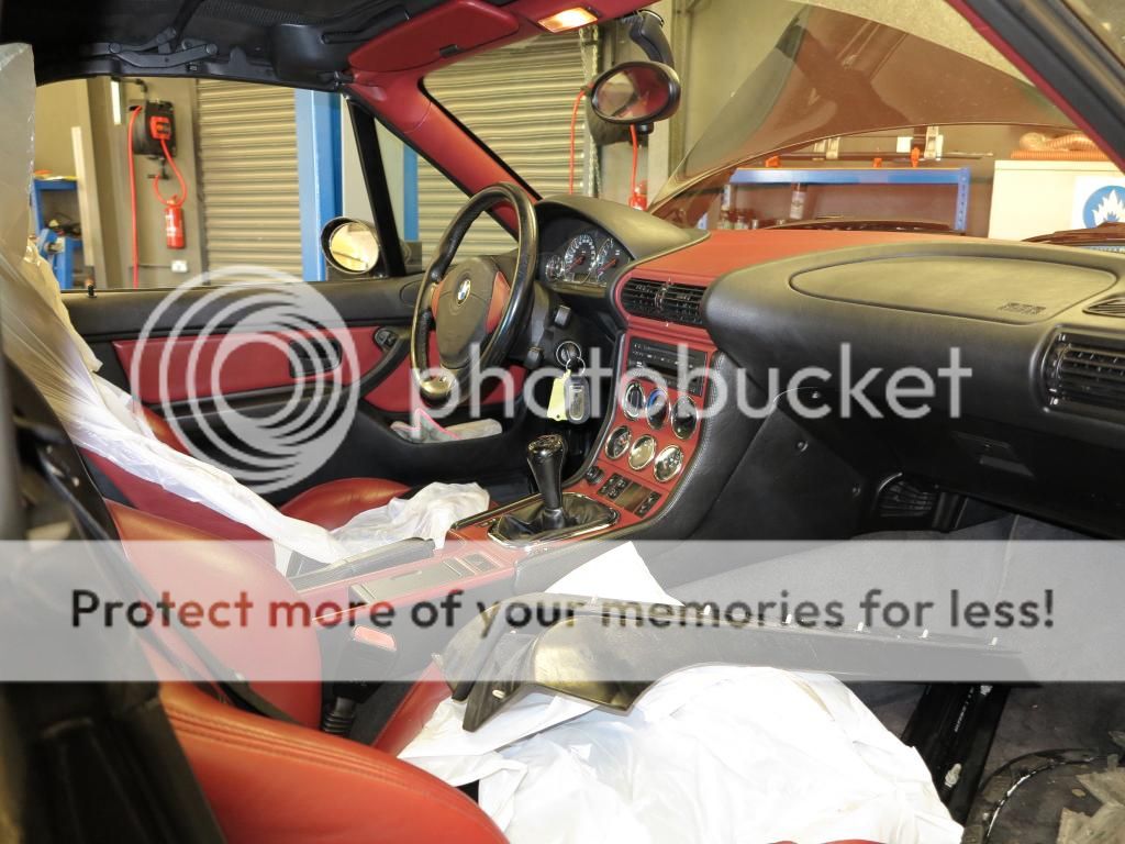

Finally where are we storing some of the bits. Inside the car before the gearbox comes out.

Now found out where the engine oil leak is coming from.
1. Nine of the cam cover bolts have been stripped, two completely. Sealant was used to try and stop the leak.
2. Bridge over the top of the Vanos had cracked. This was caused when the vanos was not aligned correctly with the pump.
3. Cracked cam carrier. Probably due to incorrect fitting of Vanos
Remedy. New cylinder head required.
UNBELIEVABLE!!!!!!!!!!!!!!!!!!!!!!!!!!!!!!!!!!

Looks like it is working. The engineers will be meeting to inspect the car and discuss findings. In the meantime BMW have ordered a new cam carrier from Germany. When the deliberations are complete we will start to negotiate who pays for what.
Tilly
Joined: Wed 26 May, 2004 20:45
Posts: 417
Location: Sussex
Re: 18 year check.
Post by Tilly » Thu 18 Dec, 2014 13:38
Result,
A master engineer from the BMW main agent inspected the car. After just five minutes the guys at Classic Heroes convinced him that the damage was caused by poor assembly.
Replacement parts have been ordered from Germany and there will be no charge.

Whilst I am waiting for the parts the work continues on the bodywork.
Underseal being applied.
The sills before with a hole and some rust.
After work
It is nice to see some progress.
Bi11

Picked up the car today.
One problem took it for a test drive and then realised I had forgotten to take some pics so the underside was a bit messy.
Car now drives superbly with no hesitation. No noise from the gearbox and changes are very smooth.
Undertays now intact
No leaking from the Vanos
New carbon capture and straightened pipes
Image[/urlNew headlight
[url=http://s606.photobucket.com/user/Tillyz ... 4.jpg.html]Image
Sill which had the hole in it.
Engine back in one piece. New cam head fitted.
Pick up one dropped off the other. Airbag light on so it needs sorting.
Drove home with the roof down, BLISS :D

Based on the findings with my car just an update on my wife's.
18 years old, 48,000 miles, garaged and not used in harsh weather.
Looks good from the outside.
Brief to Classic Heroes chec,k as with the M let me know what they find. Their report was initially mechanically little needed doing:
Replace one coil pack following diagnosis
Replace rear shock top mounts
Replace bonnet gas struts
Clean engine oil leaks from timing covers to appraise next service
Replace front anti-roll bar dive links
Replace poly belt
Renew usual fluids
In addition they would carry out and clean of underside of car. Remove undertrays and sheilds. Clean up all corrosion.
Treat with Kurust, etch primer, paint and Gravitex
Waxoyl car and re-assemble.
What did they find when sills removed.
These could not be repaired so new ones ordered.
These other two pics tell all
So, as before, checking below the surface is well worth it as looks can be deceptive!
Re: 18 year check.
Post by pingu » Sun 23 Aug, 2015 15:49
If you are going this far, I would also take off the rear wings and see what horrors lurk beneath.
This was my car when I did the same as you a couple of years ago...
Don't worry about the workload as it only takes 11 seconds to put it all back together :D ...

Like yours the tub is fine. Front and rear wings are off and there is slight corrosion but nothing that cannot easily be sorted. Two new sills at £368.96 have arrived and are being primed and painted. I'm getting the job done properly since a friend had his sills prepped and painted by a professional paint shop just under four years ago for £500 and they have now rotted through. At least I can see each step of the job being done so hopefully there are no hidden problems.
