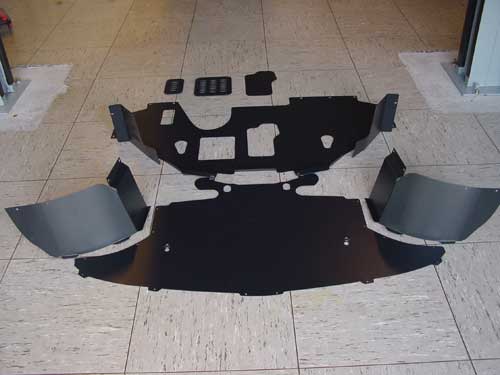

I had the terrible experiencing of discovering that my front wheel well liners are all cracked. To make matters worse, they virtually disentegrated when I attempted to remove one in hopes of making a repair. The rubber is so brittle that just handling them results in there falling apart. I haven't checked to see if BMW still stocks them. Is there an aftermarket product or other fix?

Hi Rick,
Yes, you can order any of the underbody panels from your local BMW dealer (at about £80 each from UK BMW dealers for the front wheel arch items).
I had mine replaced last year but beware they are not easy to fit as you have to dismantle a lot of the suspension to install them without resorting to cutting them !!

Returning to this topic after a a short gap of15 years, does anyone have recent experience of procuring ans fitting front wheel arch liners? I have quite a spectacular hole in the passenger side . Any alternative to BMW main dealers? I can't find any with current stock.

Chris
BMW used Auria Solutions GmbH to manufacture a new supply of liners back in 2019. They are not the crisp injection moulded quality of the originals, more of a rubber solution poured into a mould by hand, they are rubbish ...but beggars can't be choosers. If BMW are out of stock they may be worth contacting.
https://www.auriasolutions.com/products ... l-systems/
The rear liners are supplied with the holes for the damper and fixing holes pre cut / moulded but will require trimming and fettling to fit, unlike the front liners which are a blank moulding. The BMW dealer I ordered them from assured me the front liners were pre cut and drilled and a simple 30 minute job to fit, so we agreed a price (£100) for them to fit both front items. Suffice to say it took several pairs of hands 5 hours to drop the front suspension, cut, trim and fit, however the dealer did (reluctantly) to stick to their original quote but took me off their Christmas card list. You need to try and remove the old liner in as many large pieces as possible and use them as a pattern for the required holes which need to be accurately drilled and cut.
Meanwhile you can patch repair the existing liners by removing the front wing and bond, tape, reinforce from the inside. Rather than damaging the liners further when removing the connecting under tray for servicing I am told it is possible to replace the oil filter from above when the manifolds are cold and if you have very small hands.

Hi,
I such cases usually BMW owns the mould, Intellectual Property and/or has some exclusivity agreement with manufacturer, therefore it is virtually impossible to get parts or launch production batch directly with them
Regarding oil filter, yes, I confim it is possible to remove it from above, I have been doing this for the last 28 years even if I do not have so small hands
It is long and painful process but anyway much better than removing undertray...

Thank you for this information. North Oxford Garage weren't able to locate stock, so I've contacted Aura. I had previously done a permanent temporary repair with black plastic, glue and tape but the last MOT inspector wasn't happy and had it removed before conducting the test. Perhaps another attempt at repair calls as it's now Z1 weather.
