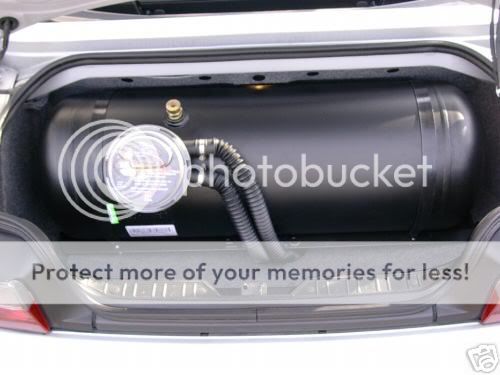

A Dutch forum member had it done a couple of years ago on his 2.8 coupe at a cost of Euro 2,500.00.
He said that he has a round tank, 60cm across and 25cm high, in the boot. (no photos I am afraid)
He did not mention how much lpg he could fill up, but in his last post on the subject he said that he had driven 380km on 40lt of gas, which was similar to his petrol usage but obviously a lot cheaper.
He also said that he had not noticed a difference in performance using lpg, but he did change his spark plugs more often than before.
Photo of a gas tank in a roadster.

i know theres no room in the boot but that just takes the biscuit! if it could be mounted under the car then id be very interested..... so would most on here too id think.

I took the car to a specialist and they had a tank that would fit the diameter of the spare well, but the tank would be sitting too low for comfort and he was worried about it getting scraped over bumps etc. Anyway he said the only realistic solution was a cylindrical tank in the boot, which would take up at least half the space, so I said no and bought a scooter instead for my daily commute to work lol :P
