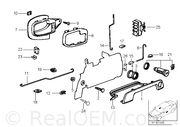

Bar (11 in top diag) connects into the lock where the 1 is pointing to on the lower diag. This connection is mechanical (not electronic). I am assuming that you have tried opening the door from inside. The first pull of the handle should unlock the door and the second pull should open the door.
Hopefully the images will help.
